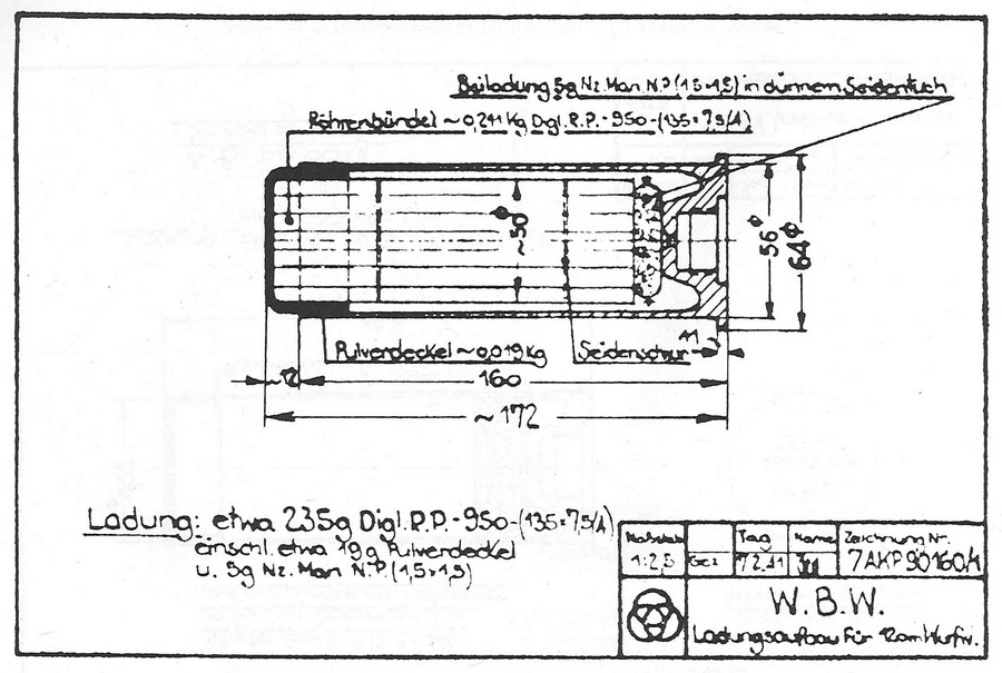

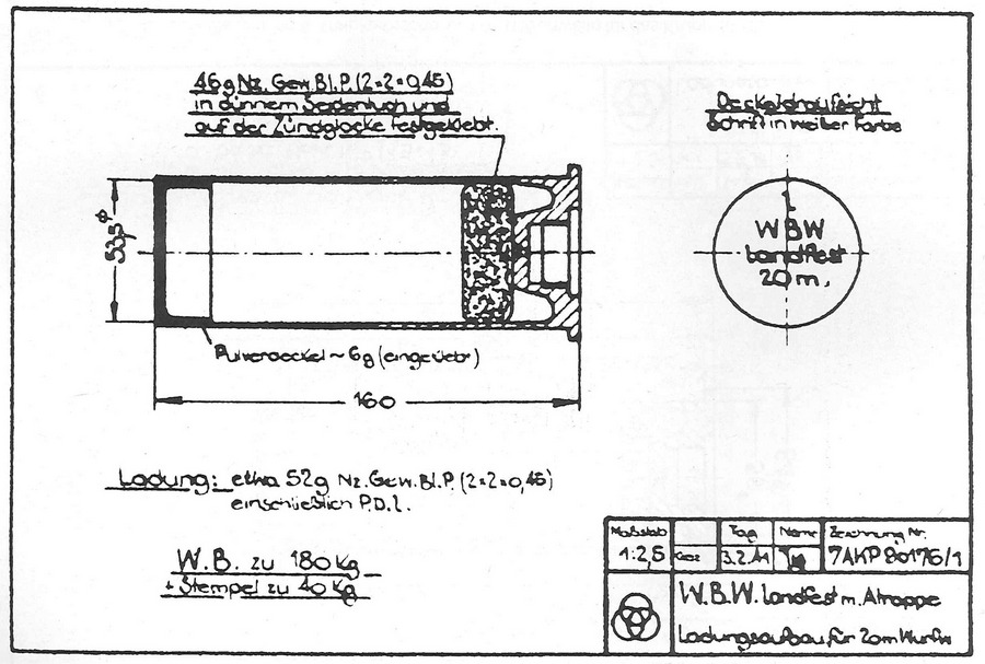

Zünder wrote:To me, this shellcase looks like a propelling charge for a german depth charge thrower, most likely the Wasserbombenwerfer C/35.
Shellcases for the W.B.W C/35 were made in brass and brass coated steel and until now i have only seen specimens made by the Polte factory in Magdeburg.
The shellcase in the picture was used for the type WBF depth charge, and had a max. shot distance of 40 meters as can be clearly seen on the cap.
Et par tegninger av drivladninger for wasserbombenwerfer - hhv. 20m og 120m kastelengde:
