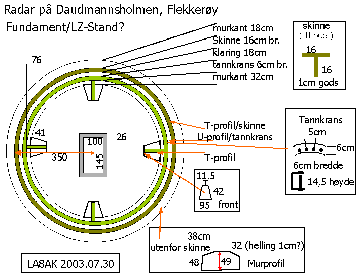

Can somebody help me with the size of the inner ring of the Freya-Fahrstuhl
and how thick is the concrete-socle?
Thanks in advice
Best wishes
Rolf
nordfriese wrote:Hi friends!
Thanks in advice
Best wishes
Rolf
I can only offer this drawing, made by the late Jan-Martin Nöding (died 2005).
nordfriese
Posts: 70
Joined: 03 May 2013 22:30
Location: Bredstedt/Tyskland
Hi JEF!
That's what I'm looking for!
Thanks a lot!
Best wishes
Rolf

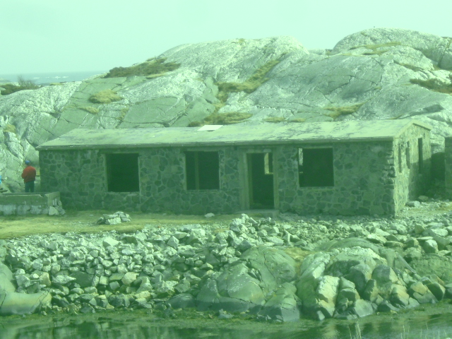

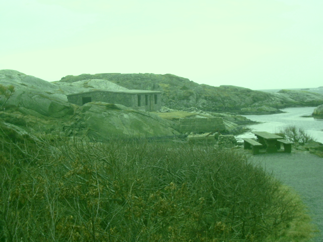

Question: At Flieder I saw some open emplacements. Can anyone tell what there use was.
Tanks and greetings
Tom
Hva var denne bygningen til? Den er nær radaren
