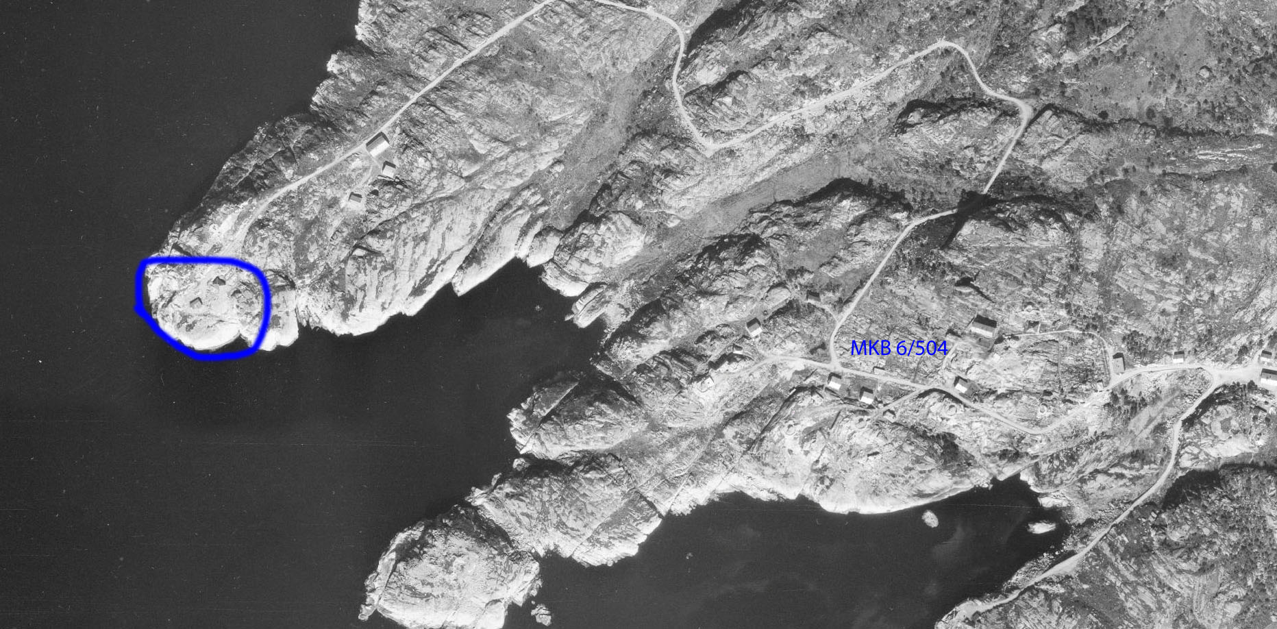

Using coordinates, Bergen Nord is at Skjelanger and Bergen Süd at Korsnes
Hello
Thank you Rolf for Your interesting postings With details of the Küwas, MSS and Küstenhorchanlagen in Norway.
As mentioned by Tarjei the KHA Bergen-Süd was at Korsneset, close to MAA 6/504.
Addeda photo that shows the position of the barracks to the men of the KHA Bergen Süd.
