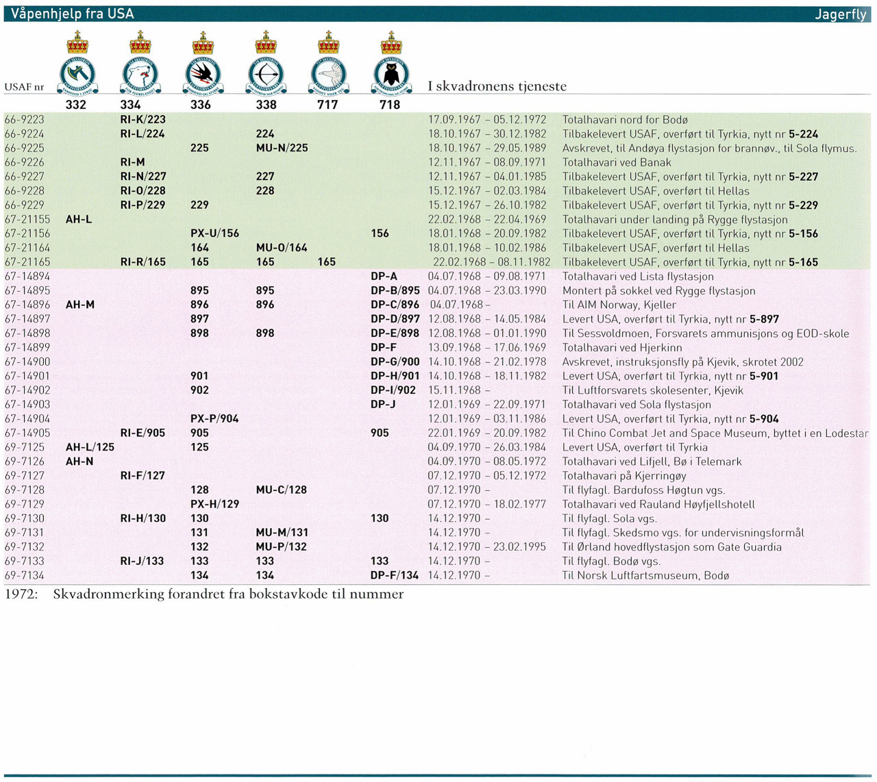

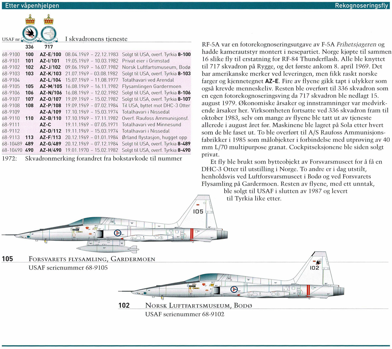

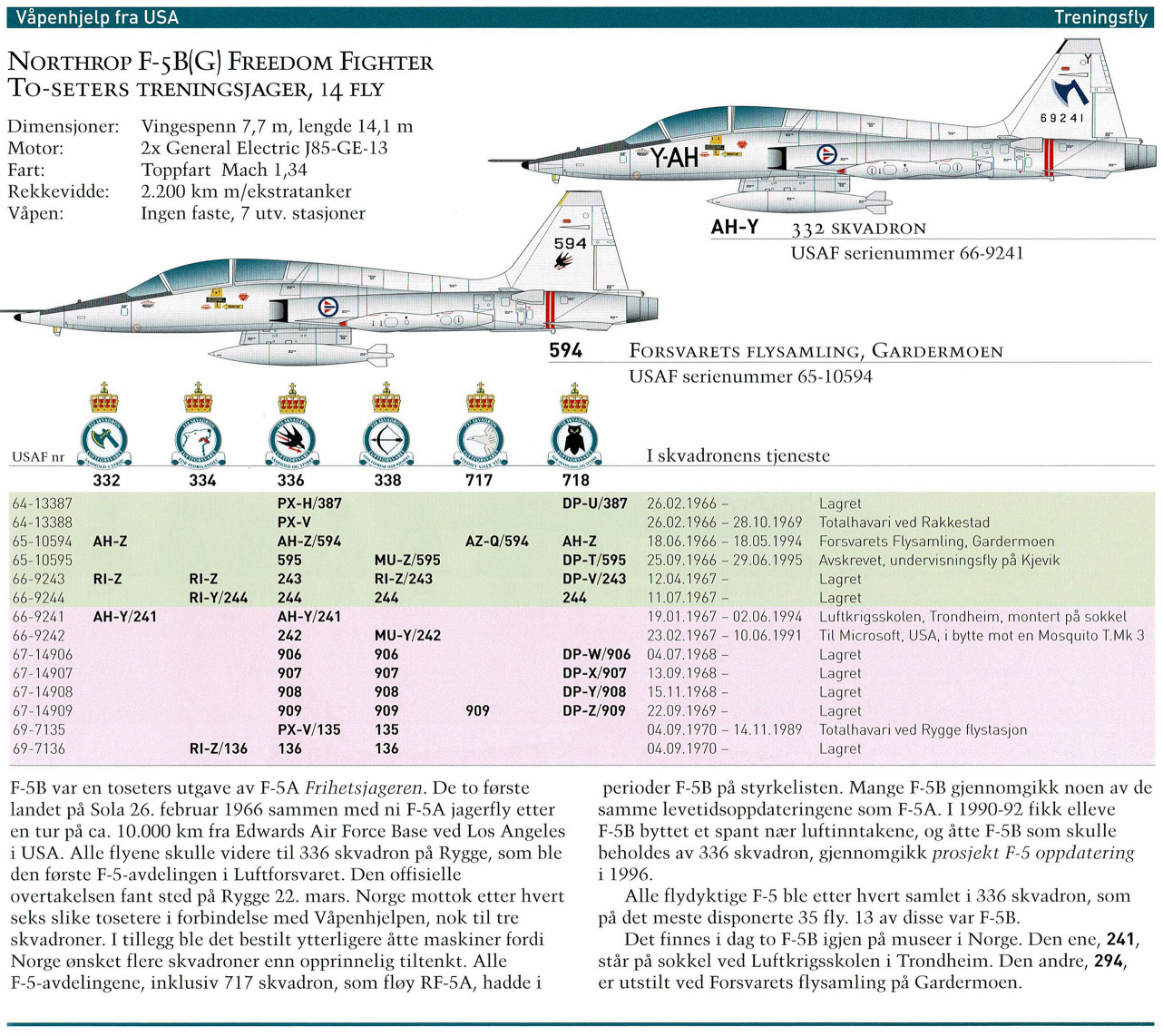

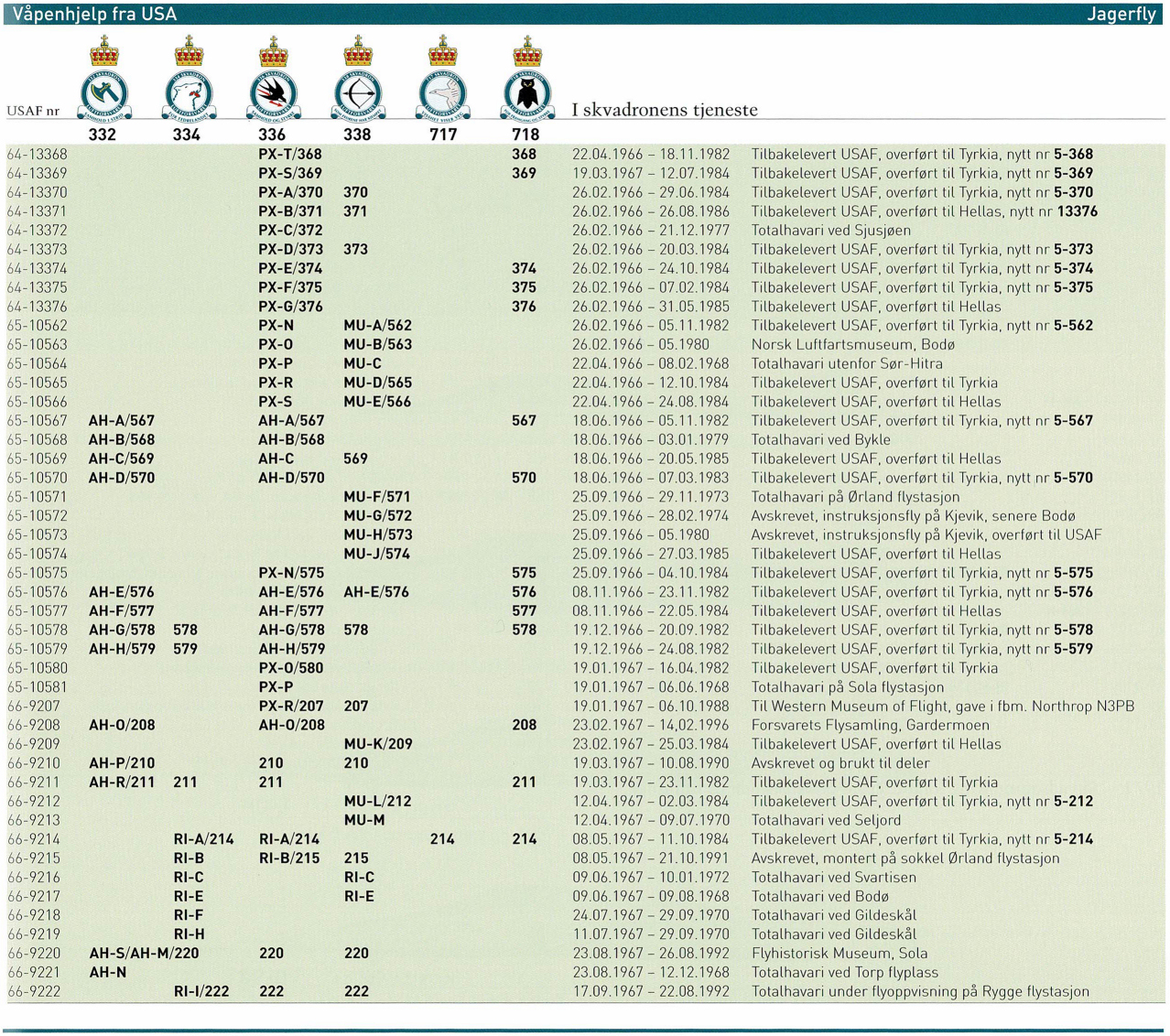

I have also attached scans from "Norske Militærfly 1912-2013" (Sverre Mo & Ole Bjørn Sælensminde, 2013. ISBN 978-82-7128-687-3 ), where you can see the history of each plane in the different squadrons.
F-5A (1 of 2)
F-5A (1 of 2)
F-5A (2 of 2)
F-5A (2 of 2)
F-5B
F-5B
RF-5A
RF-5A
